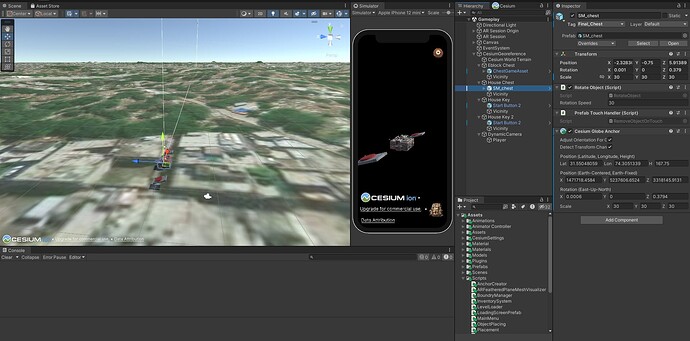

I am experiencing issues with anchoring objects in the real world. When I move towards them, they either move away from me or in random directions. Additionally, when I am standing still, the objects automatically start moving in a direction related to the camera. I’m not sure what I’m doing wrong, and I’m running short on time to deliver this project. I would greatly appreciate any help I can get. Here is an attached screenshot of my project hierarchy.
To anchor objects in the real world, you need to attach a CesiumGlobeAnchor component to them. It looks like your “SM_chest” model has a globe anchor, but its parent object doesn’t. Is that the behavior you really want?
Thank you for your response. I tried the solution you suggested, and I’m sorry to say it didn’t work. Is there a way I can provide you with any further information or the project package? I really want to get it working on Cesium. Thanks.
If you have a CesiumGlobeAnchor on an object, and it’s still moving away from you, I think it means there must be some application logic doing it. Perhaps even the AR framework itself? It may be helpful to look at the transforms of the player and the objects to see how they are changing as the objects run away.
