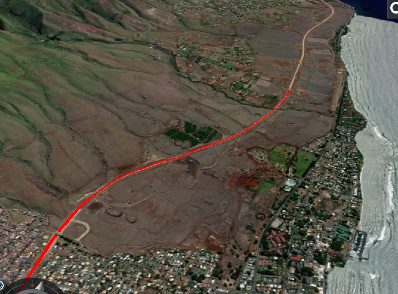

Hi! I’m running into an issue where portions of polygons clamped to 3D tiles appear and disappear as the camera moves. It has the visual effect of masking part of the layer. It seems to happen more often in specific areas of terrain and with polygons of all types. A sandcastle demonstrating the issue is linked below as well as images of the issue. You can move the camera from side to side to see parts of the polygon over the road disappear and reappear. Any help would be much appreciated. Thanks!

Hi, thanks for the reply! Currently seeing this in both Safari and Chrome 117.0.5938.92 on an M1 MacBook pro and on iOS safari on an iPhone 12 mini. It seems to work fine in Chrome on an Intel MacBook.
