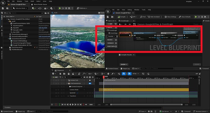

PlayMovieSequencer blueprint node freezes MRQ render after v2.15.0
Why this setup don’t work anymore, MRQ render just freezes when I hit render. It worked just fine in v2.15.0, but all following versions seem to be affected.

Hi @kentzversky,
Thanks for reporting this. I can reproduce the problem, and I opened a pull request with a fix:
I also create a branch of Cesium for Unreal with this fix:
You can download a pre-release build that includes the fix using the instructions here (once CI finishes generating the binaries):
