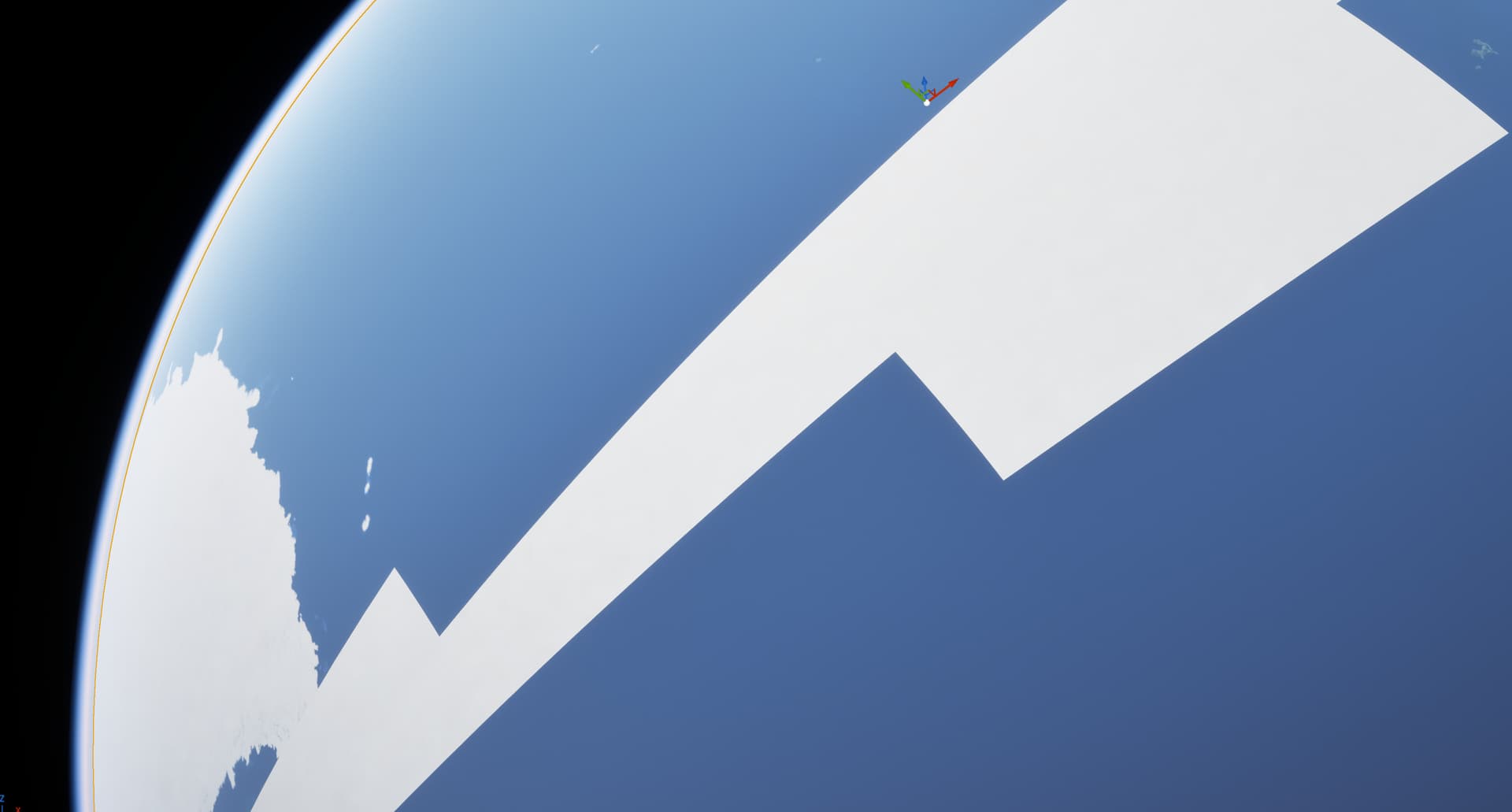

try zooming to north pole and south pole and see for yourself. tiles starts to disappear
Like this?
That’s caused by the Bing Maps tiles (in this case) using the Web Mercator projection, which stops at ~85 degrees latitude. When a terrain tile is at least partially covered by a texture, that texture will get stretched out to the edges. But if a terrain tile doesn’t have any imagery tiles at all that overlap it, you’ll get that white, untextured look.
We have an issue covering this, but it hasn’t been a high priority so far:
