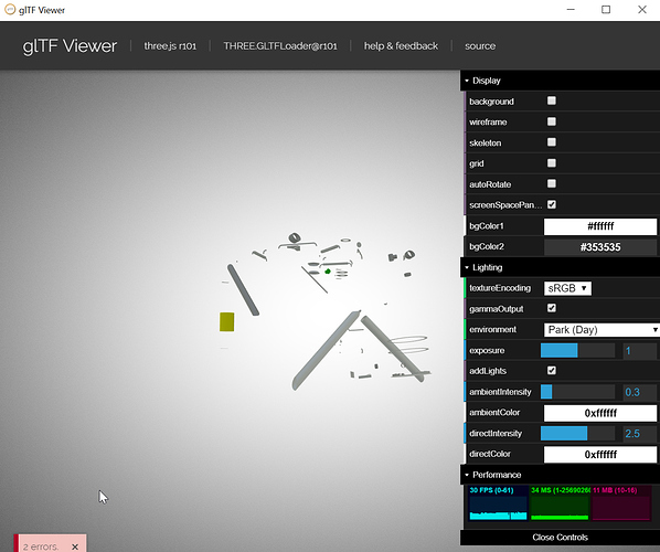

Unable to load dracoed-b3dm, works fine in Threejs gltf-viewer
1. A concise explanation of the problem you’re experiencing.
Unable to load b3dm, display fine in Threejs gltf-viewer
The 2 errors are about “KHR_techniques_webgl” not supported by threejs gltf-viewer
Non-dracoed B3dm loads fine in Cesiumjs
