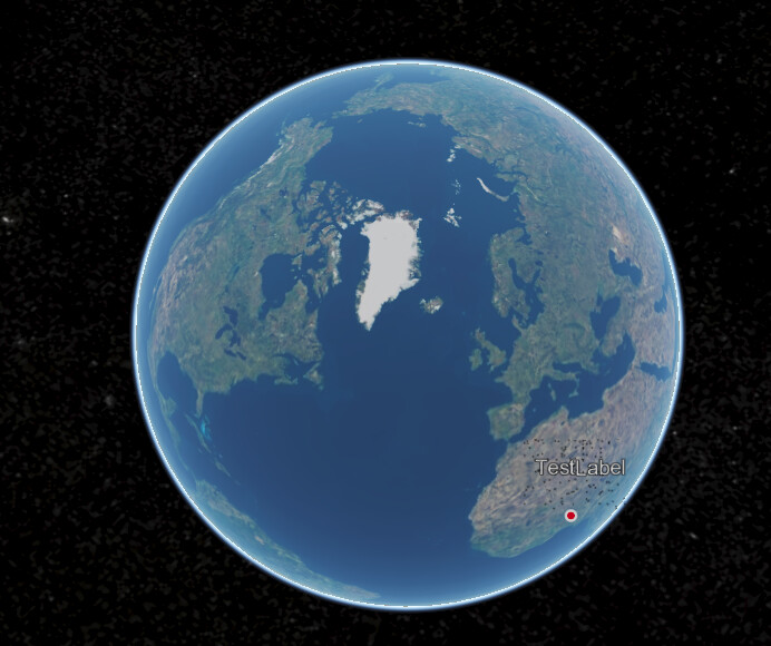

Hello everyone,
I encountered a weird graphical artifact. The label of entities is surrounded by small black dots. The issue first occured when I was building the project using webpack (according to https://cesium.com/docs/tutorials/cesium-and-webpack/ and https://github.com/CesiumGS/cesium-webpack-example). The issue itself is not reproducable in cesium sandcastle and must somehow be caused by webpack / the webpack config. I don’t get any errors while building the project or viewing it in the browser.
The issue persists in chrome and firefox, im using windows and the latest recommended node.js version and the latest node.js dependencies:

Here are some pictures of the artifact:
I’m gonna share a simplified code example where the issue still persists, since it might be useful to find the error:

I get the same weird artifacting when using Brave browser.
Ok I managed to resolve the issue. It seems like a browser plugin was interfering with Cesium. By deactivating the plugin “DuckDuckGo Privacy Essentials” the problem didn’t occur anymore.
I’m not sure how the problem was caused and why it only occurs when building the project with webpack, but that fixed it for me.
I had the same issue in Firefox, was able to get it to go away for me by disabling this setting:
“Privacy & Security” / “Enhanced Tracking Protection” / “Suspected fingerprinters”
My guess it’s something with how the js is minified that set’s it off.
This issue is tracked here: Firefox fingerprint protection causes pixelated label backgrounds · Issue #12480 · CesiumGS/cesium · GitHub
