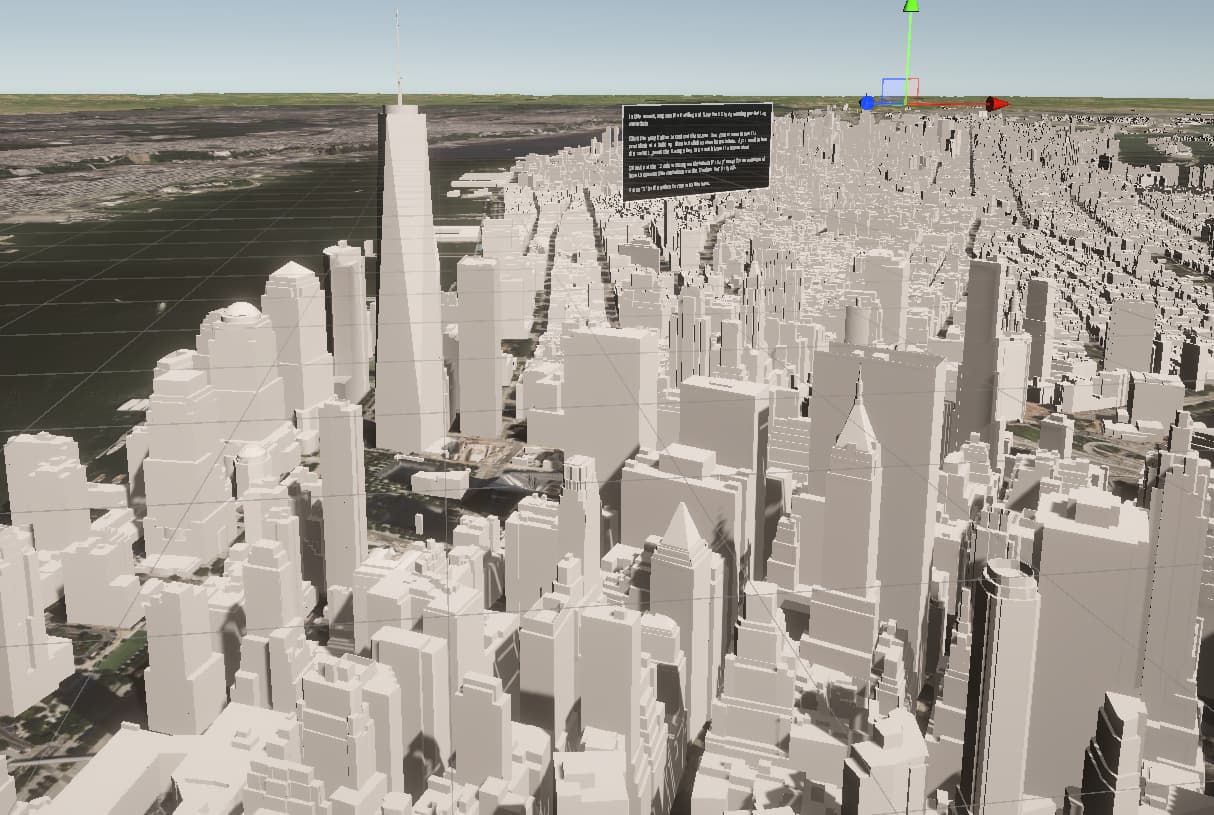

The model in the video is a photogrammetry tileset - specifically Aerometrex’s Denver, I believe. If I’m right that that’s Denver, it can be found in in the VR01_CesiumDenver and 04_CesiumSubScenes levels in Cesium for Unity Samples. There are also similar tilesets in scene 02 (Melbourne) and 03 (San Francisco).
Asset ID 75343, shown in your error message, is an untextured model of buildings in New York. It should look something like this:
That error is suspicious though. Perhaps some firewall or proxy is preventing your system from connecting to Cesium ion?
