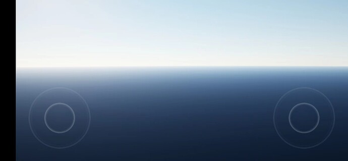

I have a trouble that android lose map data.
After package “Cesium for Unreal Sample” for Android use the map 01. There is no Cesium Data ,like Terrain and 3DTiles.etc.
I use my Cesium account to load online Cesium Severce run normally on Windows .All functions are normal.
However on Android ,lose data ,seems it does not connect to Cesium to get auth token so that cesium can not load data
What’s the problem with this?
I don’t think there’s any simple way to get the same results as on Windows, because Unreal’s atmosphere system works differently on mobile devices. Have you tried checking “Enable Mobile Rendering” on the CesiumSunSky? You may also find some of the ideas here useful:
Depending on your application, it may be adequate to simply turn off the atmosphere entirely, or fade it out as the camera height increases.
Hi ~Kevin
I enabled “use mobile rendering “
Surprise work fine

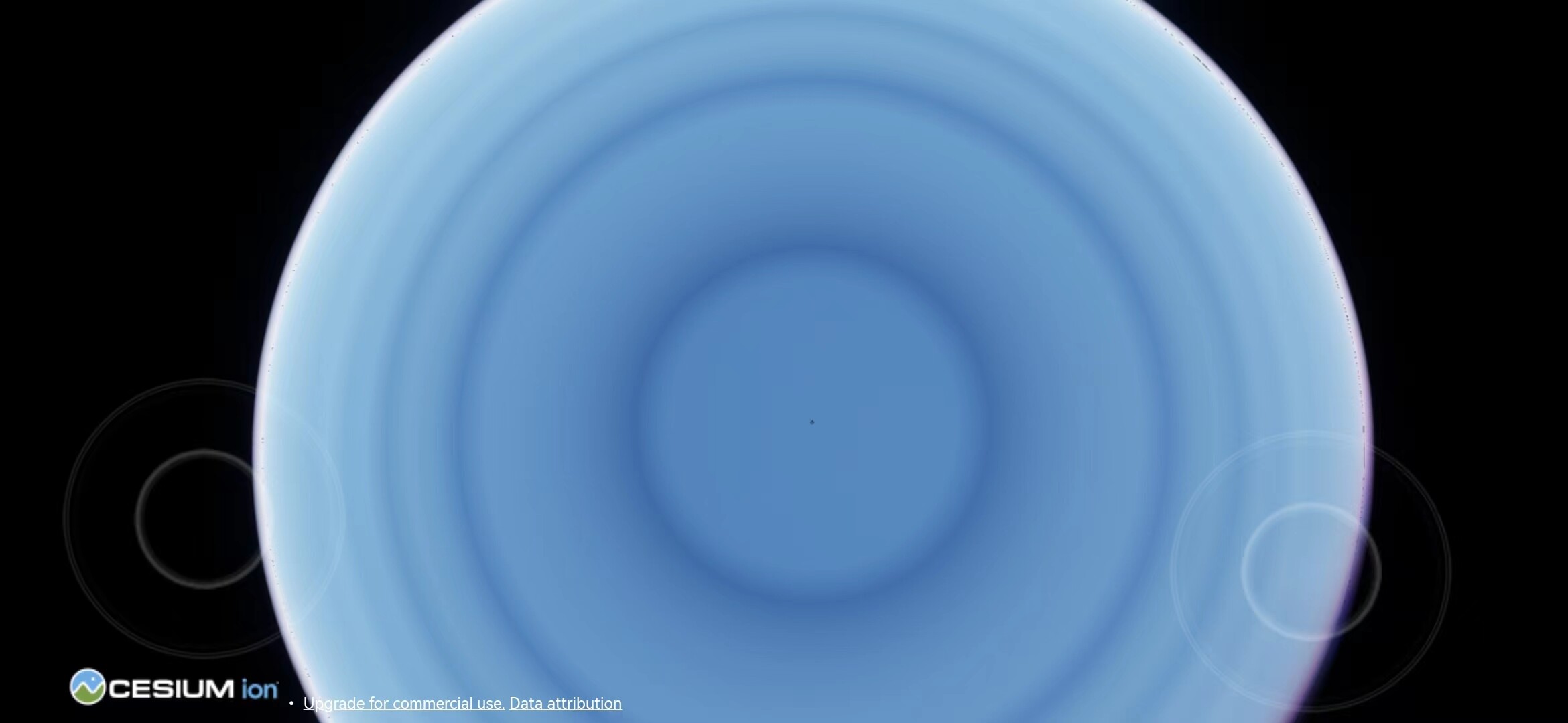

But still has another problem
When I increase camera height , The latitude and longitude will rendered like a “black line”.Is this correct ?
