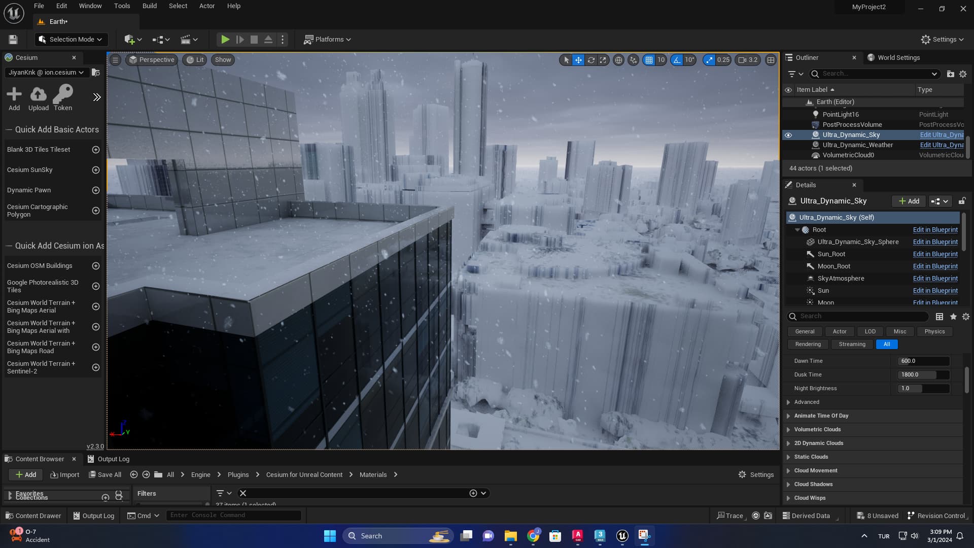

1- How can I get the area I drew in red as a mesh with its textures ?
2- How can I add coordinate information to buildings? In my model, the snow only holds the surface that is 90 degrees. Google Earth keeps snow on all surfaces because there is no coordinate information on the map. How can I solve this?

1- But it is not suitable for use in this way. I want to make a presentation to my client, but every time he turns the screen, it loads. When I rotate, it keeps loading but I’m actually in the same location. I’ll post a sample video, there is no loading here. How can i make it look like this ?
2- When it snows in unreal engine, it keeps snow on horizontal surfaces (roofs and floors). But Google Earth buildings keeps snow everywhere( walls,windows) because there is no coordinate info on cesium buildings. I think unreal engine coordinates of google earth buildings need to be introduced. I couldn’t figure out how to do it.
