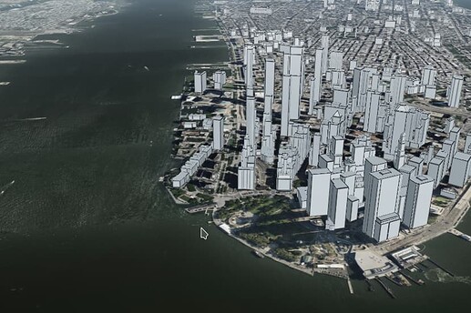

https://i.ibb.co/hY4dKTY/Screenshot-37.png
How to remove this? we need only Manhattan.
Hi @maxtorgr,
Thank you for sending over that screenshot. Are you looking to remove the OSM buildings or the terrain?

We are looking to remove terrain + map outside manhattan. @sam.rothstein
Hi @maxtorgr,
You are going to want to use the ClippingPlane object in our API. This will allow you to only showcase data from a particular region on the WGS 84 globe. Here is a sandcastle demo with code that can help get you started:

Perfect it worked for map. now buildings are showing all over map , also ousite the clip area. how can we clip buildings also?

We are using “New York City 3D Buildings” .
We need to keep only manhattan 3D Buildings and remove the rest. check the picture.
The solution that I eluded to above is the easiest way to show only a subset of the Open Street Map buildings dataset. I recommend searching for a better query, or possibly numerous queries that will only showcase the buildings that you would like to display.
