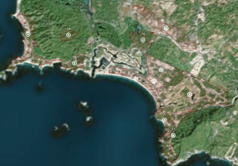

I’m looking at using the IconStyle scale in KML in the kml-branch.v1.3
Having the scale at 0.4 in IconStyle in the kml-branch v1.1 renders the labels smaller:
I’m not sure how easy it would be to go back to the kml-branch v1.1 style for rendering IconStyle scale. I’m not sure if we are going to use labels in this project or not but I’m preparing for the worst (1,000 + labels).
Is this an easy fix or should I rather be adding labels via primatives for a KML?

Zach, can you post (or email me directly) an example of a KML file that shows bad behavior. Using the head of the kml branch and loading a file with IconStyle settings; Cesium seems to match Google Earth. I suppose it’s possible that the old behavior was incorrect and the new behavior is right; but if you have a test case that shows a problem I definitely want to fix it.
