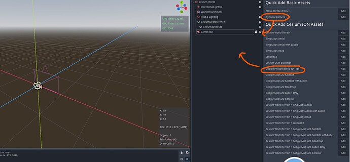

Following the guide, I have logged in to Cesium Ion and have added in a Dynamic 3D Camera and a Google Photorealistic 3D Tiles node into my scene.

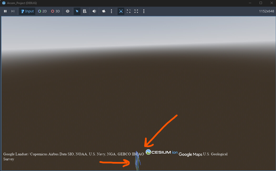

But as I press play, I initially get no tiles loaded and the Camera is all tilted compared to the World Environment. As I spin the camera around, I do get some tiles rendering, but all the way at the bottom of my screen and very far away.

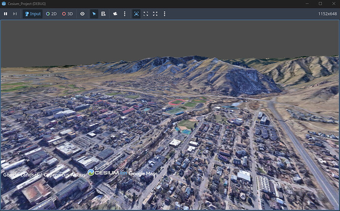

Change the Longitude and Latitude to a real world location and changing altitude does not seem to change anything, unfortunately. Moving my camera around for some time leads me to tiles looking like this:
