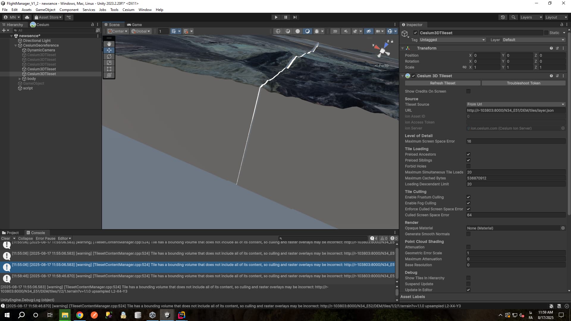

I am tyring to collect a piece of earth in cesium for unity.
I convert my dem layer to terrain and a json file by cesium terrain builder.it gives me some folders contain .terrain file and a layer.json file.
I do this for 4 tiles but my problem is that when I load my tiles to cesium for unity, there is gap between my tiles. by the way I dont want to merge my dem files. they should be seprated.
as you see in the picture.the bounding is exact .first pic bound(N34_E52 TO N35_E53) PIC2 (N34_E51 TO N35_E52)
Hi @goli_spot,
That sounds like a problem with Cesium Terrain Builder, so you’ll have to contact the developers of that project. If you believe it’s a bug in Cesium for Unity, let us know, of course.
Our terrain tiling tool is Cesium ion. You might want to give ion a try and see if it works better for you.
