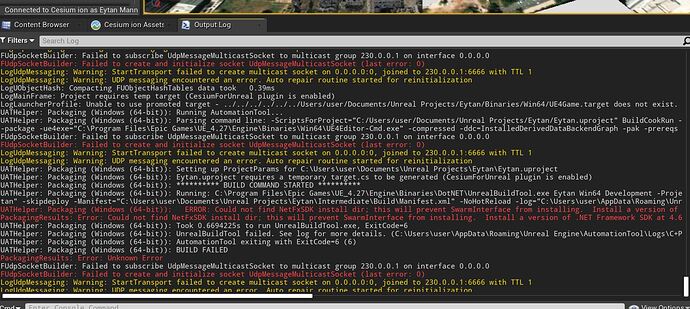

It looks like you might be missing some prerequisites for Unreal Engine. This post might help:
