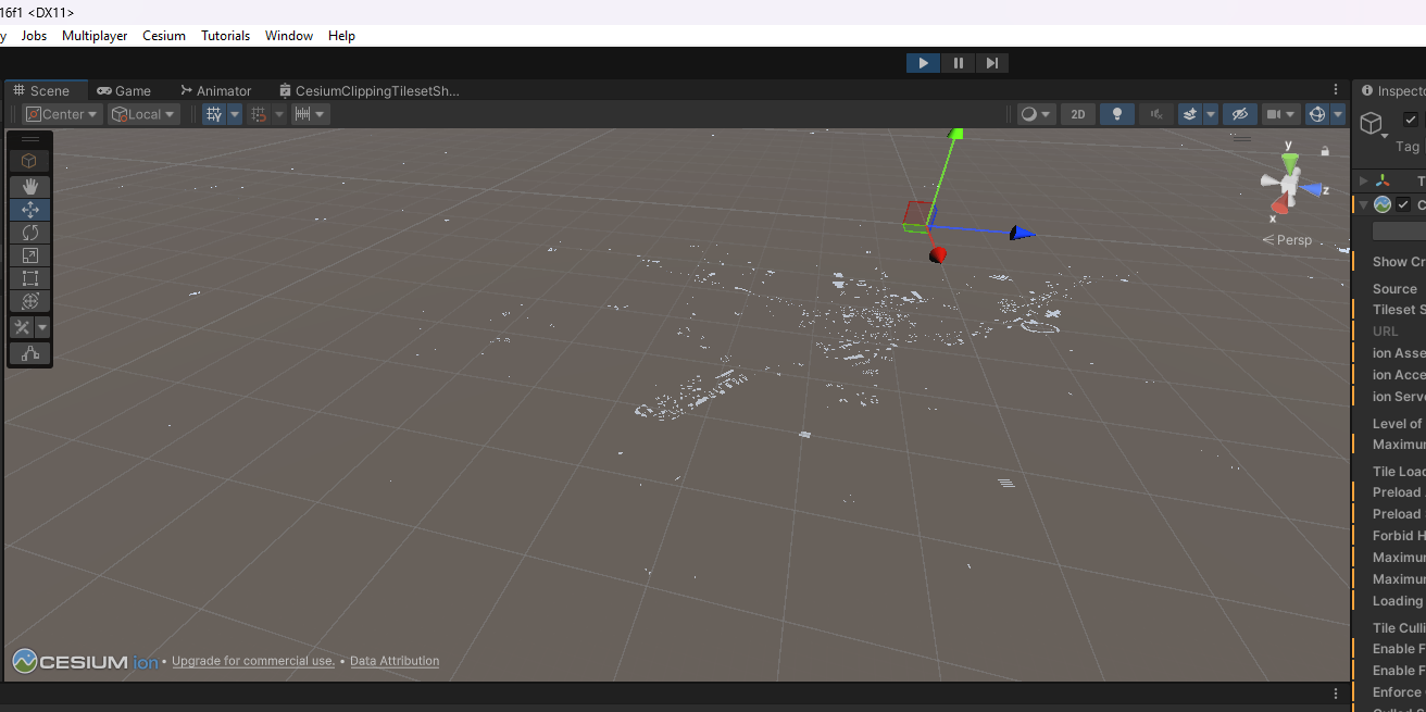

I’m trying to make a project anywhere style map and this is what i’m getting with the provided code and tutorial, is there a lead on the problem?
Or better yet can a material and code snippet premade be merged into cesium that works

Correct. The CesiumTileExcluder has a slightly different use case than CesiumCartographicPolygon, and can be thought of as a “floating boundary” in a map table example.
Thanks, do you have any tips for getting the material working so I can actually get the map table itself working?
Hard to recommend a course of action without knowing exactly what your project looks like or what you’re trying to do next.
The more specific your question, the better chance the community will have to answer it.
