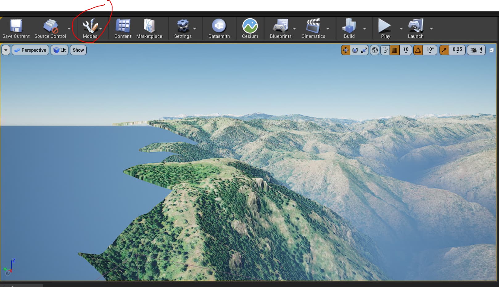

Hi, i got some more info on this one.
I’m having the same problem as Roger, and getting the 401 code in the output log.
Still, i found i way to display the cesium data by switching to “landscape” mode.
If i go back to “select” mode, the loaded tiles stays in the field of view, but no new tiles are rendered.
So it’s not a solution, just so you know that the data is there, but there seems to be a bug in the “select” mode.
im adding some screenshots:
