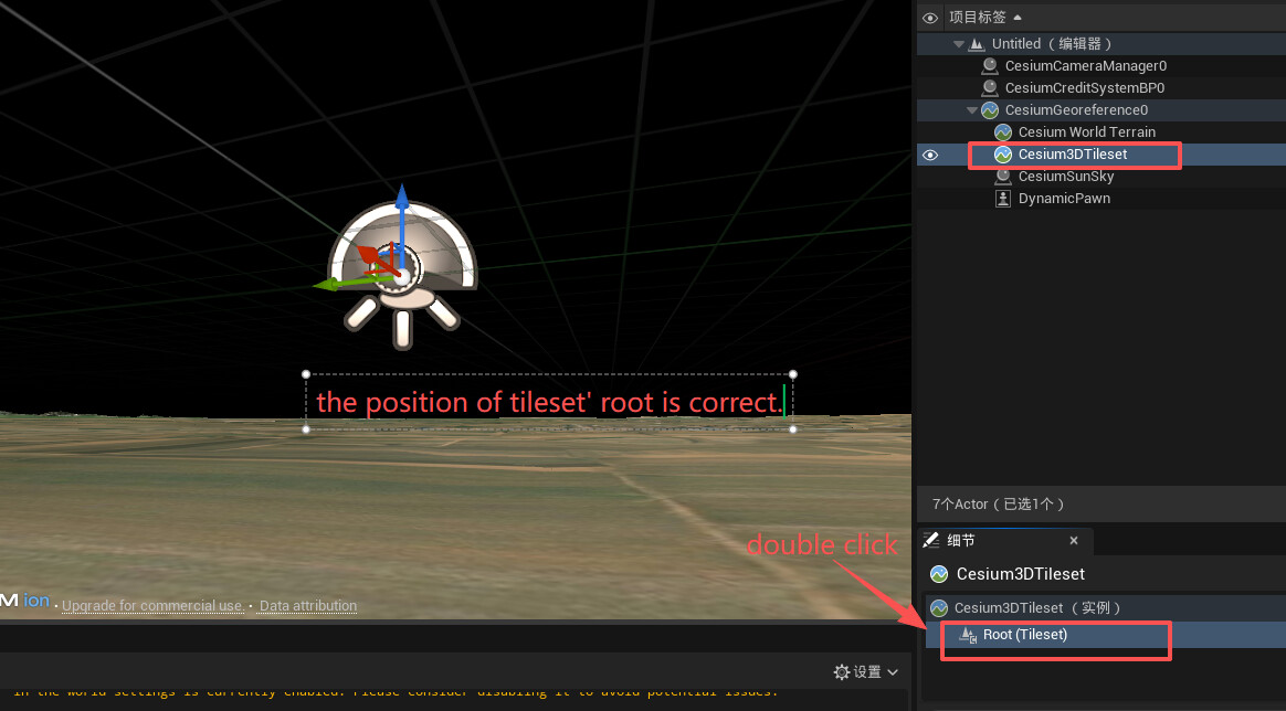

The model position is incorrect when load 3dtiles from local file in unreal
the same 3dtiles, and set the same latitude(36.1104222745),longitude(119.6523071842) and height(98.8219256536) position.
1028-3elems-2.zip (12.4 KB)
when add it to unreal by “blank 3dtileset” with local file by “with url“, it’s position shows not correct.
but add it to unreal by “from cesium ion“ (upload it to cesium ion),it shows correct position.
also in cesium js,it shows correct.
please help me.:sweat_smile:

I downloaded your zip file and noticed that the 3dtiles-json has the following asset:
  "asset": {
    "version": "1.1",
    "extras": {
      "ion": {
        "georeferenced": false,
        "movable": true
Additionally, there are no transforms on your tiles, and the root bounding volume seems to be positioned near the center of the Earth. So this tileset does not appear to be georeferenced at all.
If you georeferenced this tileset in Cesium ion, you might want to try redownloading the again. Maybe the transform wasn’t baked into the tileset after you changed it?
