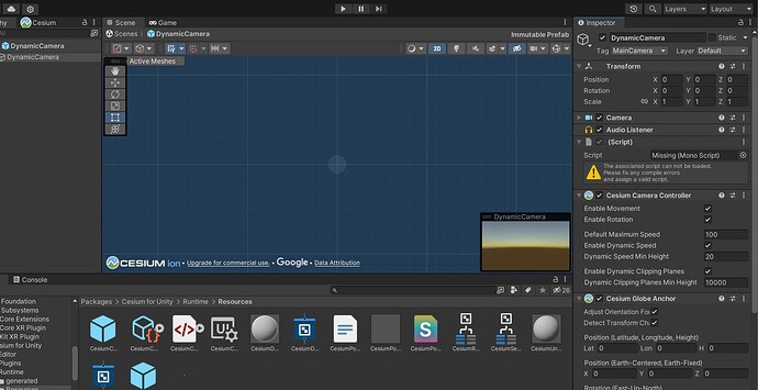

I hae the latest version of cesium and I tried changing back to an older version and then updating to the latest version again, but the dynamic camera is always missing its script. Help?

could you tell me what the script is or provide me with the script so I can attach it? I don’t want to mess with my project I have worked hard to create by uninstalling and reinstalling the whole plugin :frowning:

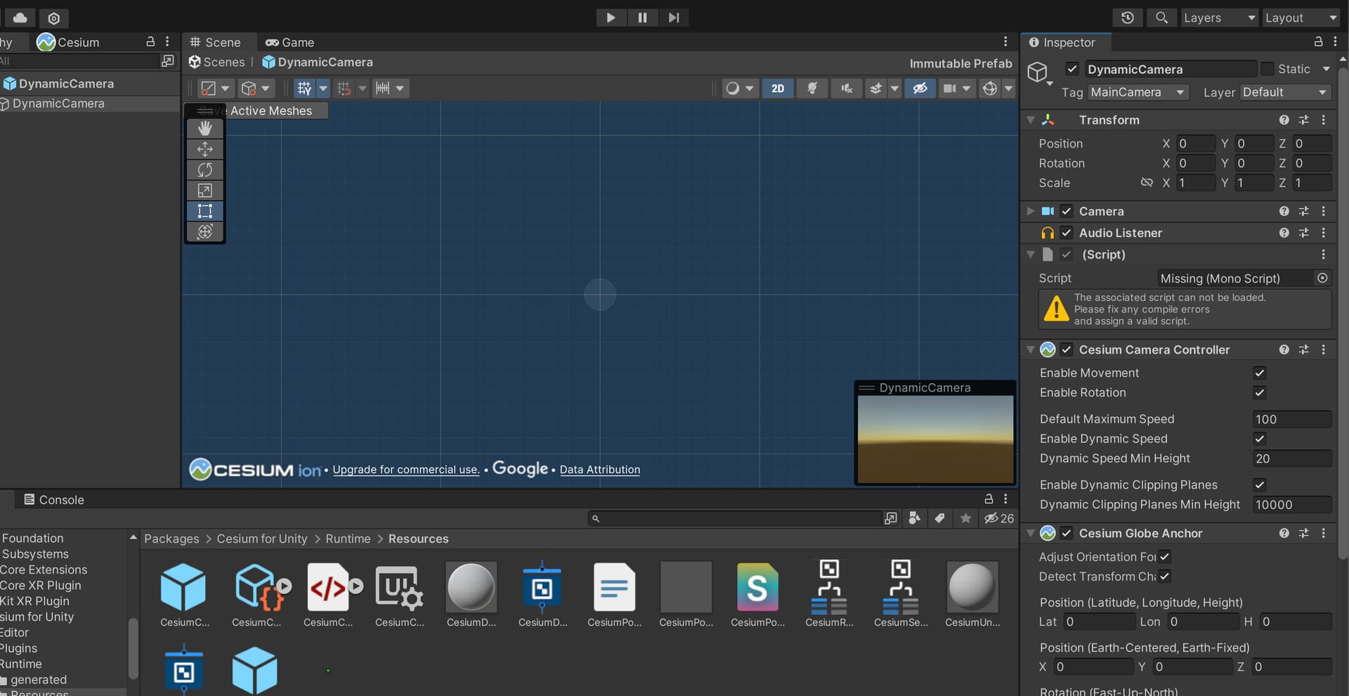

Based on comparing your screenshot to my own system, I think the missing script is “Universal Additional Camera Data (Script)”:
If that’s the case, this is specific to the Universal Render Pipeline, so it’s probably normal and harmless for it to be missing if you’re using a different render pipeline.
