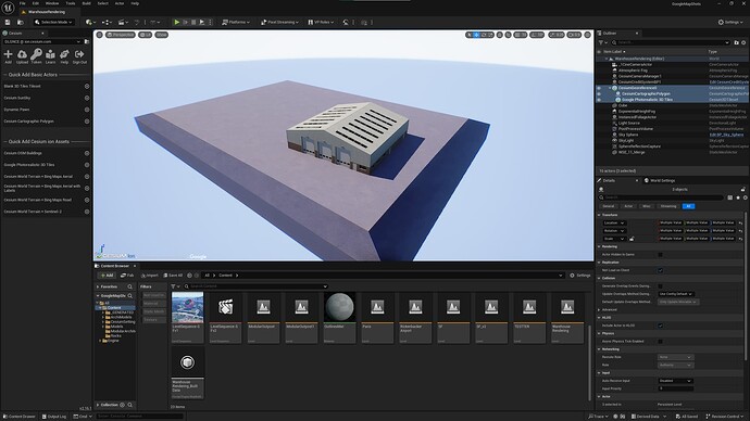

  • Other tilesets come through distorted (see screenshot)
